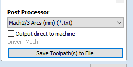

(@sjorzzzie)
Beiträge: 30
Succes! Thank you sooo much. Only im not so happy with the result. I draw a 100mm round but 10% is off, it looks like it is shifter after the first round. Which export file do you use? Now i use Mach2/3 ATC Arcs mm (see attachement):
Veröffentlicht : 21/01/2016 7:20 p.m.

Michael
(@mikath)
Beiträge: 59
Najs!
Happy to help you!
I'm using the same post processor.
Strange that the two circles not center each other.
Did you have a tool change between the circles and miss zero X and Y... :dry:
/Mika
