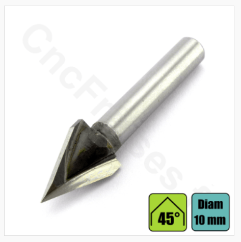

Yesterday, I strated to engrave a piece of exotic wood (movingui) with this settings : (please see the file attached)
V endmill 10mm 45°

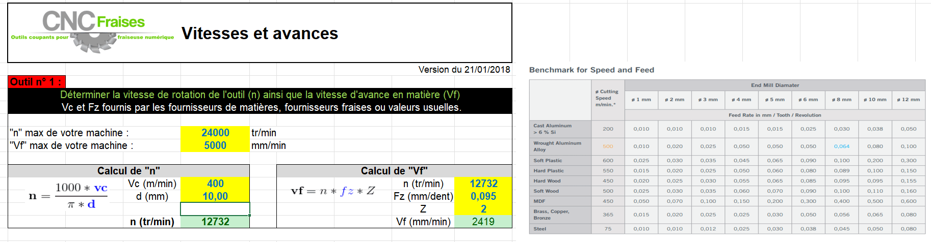

cutting speed : 450
n (rev/min) : 14324
Fz : mm/tooth/rev. : 0.0095 (stepcraft benchmark)
Z : 2 tooths
Calculated Feed rate : 2722 mm/min
So I think the calculated feed rates for V groove endmill is too high??? I tested it @24000 rpm and feed rate : 150mm/min and seems working but gives me a work of 2 hours just for a little engraving...
Some advices from your experience?

This is the v groove data
