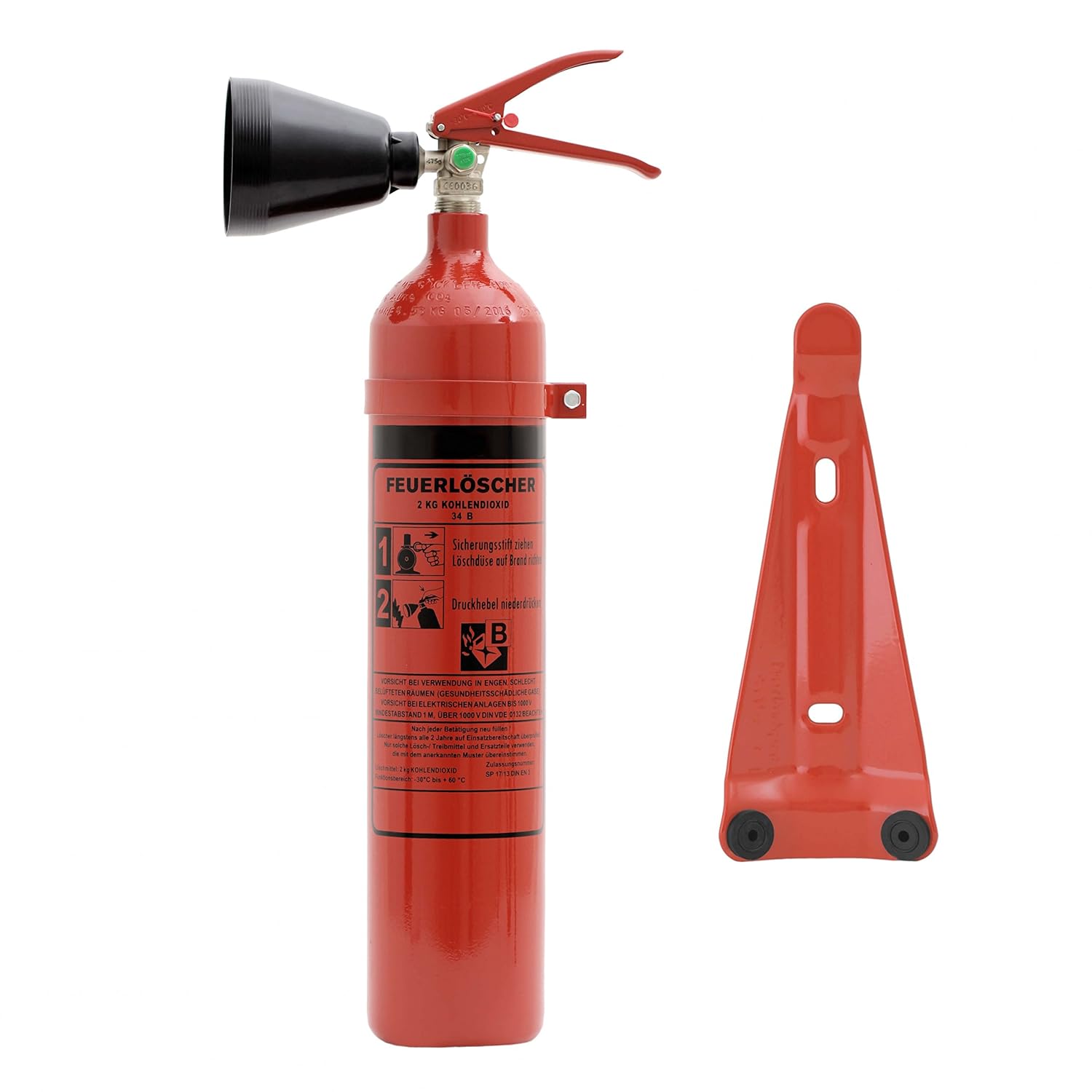

I use a CO² extinguisher, because it's not all waste, if you have to use it ;).
Feuerlöscher 2kg CO2 Kohlendioxid EDV geeignet DIN EN 3
